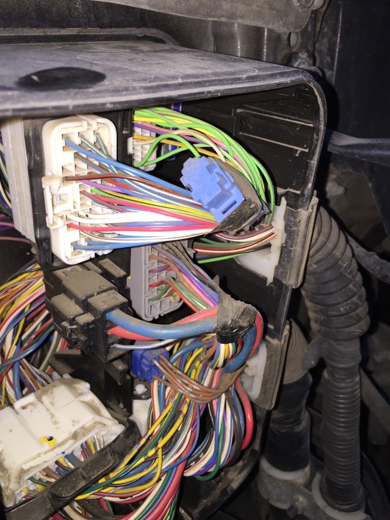

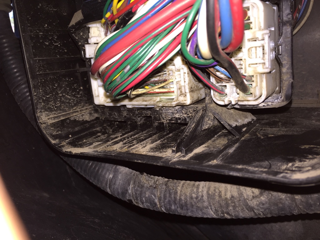

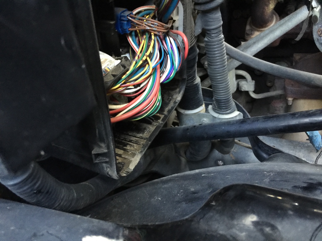

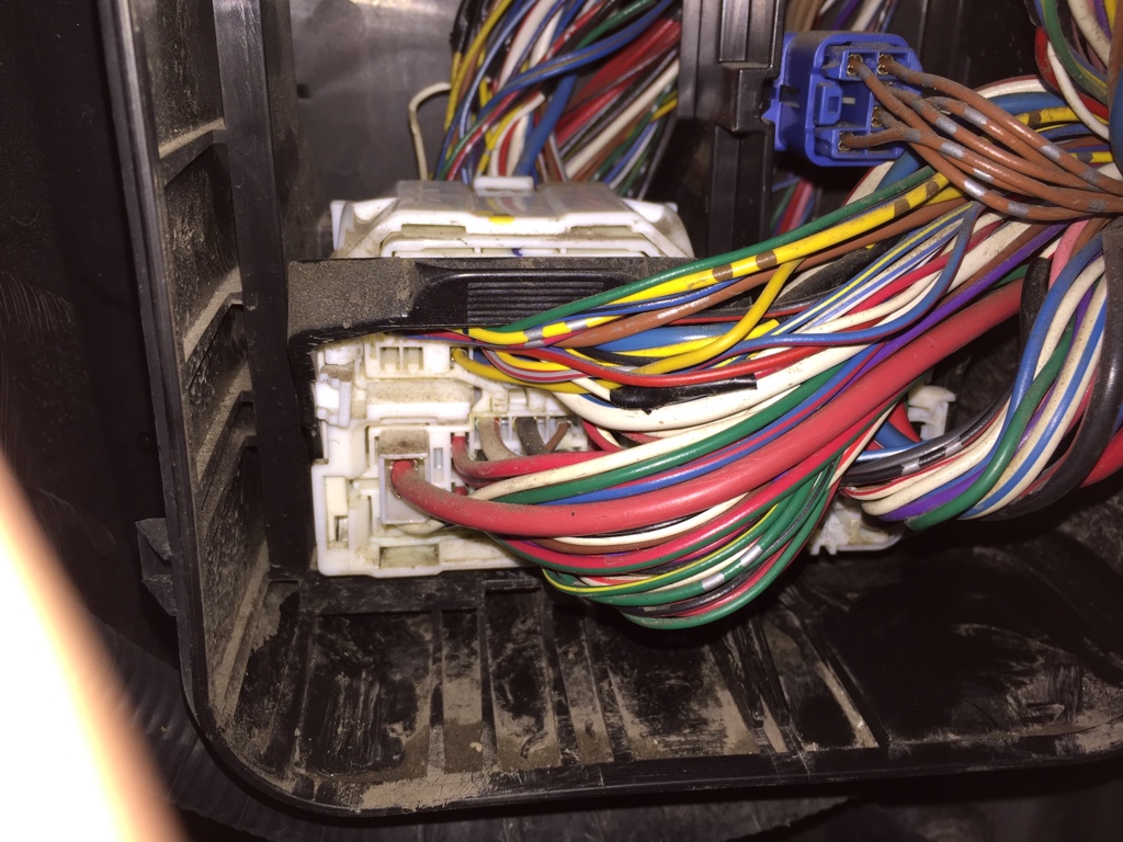

Don_vincentio
Back to more problems after heavy rainfall, this time though I think I know what the exact culprit is, opened the harness box from under the hood, and there was some residue on the bottom as well as it was wet, and one of the harnesses looks like it's been exposed to water for a while.
greasytshirt
Mechanic
Last week I ran into a truck with this same issue. And the crazy problems you are describing are not abnormal when water gets in here. Essentially we've run into the solution at about the same time.
This may be warrantable. There is a new cover with an updated seal available. If the pins cannot be cleaned, there is a TSB out on how to replace the harness connectors.
Don_vincentio
My trucks a 2011 with 163,000 miles what are the chances it's going to be covered under warranty? How do you suggest I bring it up to the dealer? I've got two near me, one that loves to charge for every single thing they do no matter what, and that isn't helpful much, while another may be able to help and might be better with this issue.
greasytshirt
Mechanic
Approach them with the knowledge that this is a known manufacturing defect and you want the damage covered under warranty. Ask them to take pics of it and send them to their TSM.
