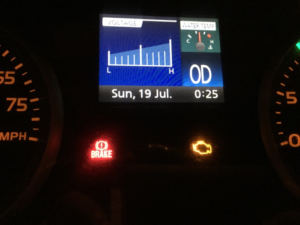

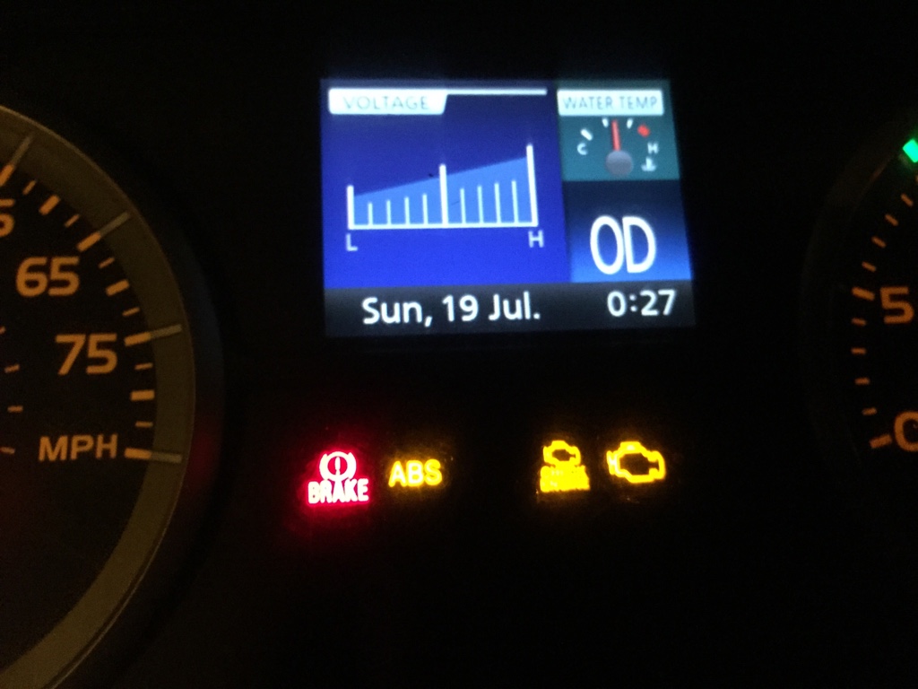

What condition are your batteries? All of these things can be set from low voltage, including a battery disconnect too soon after turning off the ignition.Beautiful new problems on my 258. Rained pretty good today for a good hour at that time the truck was parked, had to to go out after the rain and abs was on blinked 4-4 rear driver sensor which was cleaned and is good, finally went away after it rained again pretty hard for an hour and testing all the fuses, then the check engine came on codes are
P240f
reductant system perform and bank 1
P0562
System voltage low
P068a
ecm/pcm power relay de energized performance too early
w![]()
The batteries seem pretty fine to me, I haven't hooked up a tester on them yet. But without the tester no issue till after heavy rain fallWhat condition are your batteries? All of these things can be set from low voltage, including a battery disconnect too soon after turning off the ignition.
Ground wires, in particular, can give numerous problems. With that said, I think you have a different issue. The codes you are showing me look like those from the ECU, but not the DCU (dosing control unit).
What are you using to pull these fault codes? P204F indicates an SCR malfunction, but those codes are stored within the DCU. P204F can't be reset without addressing the DCU's codes.
