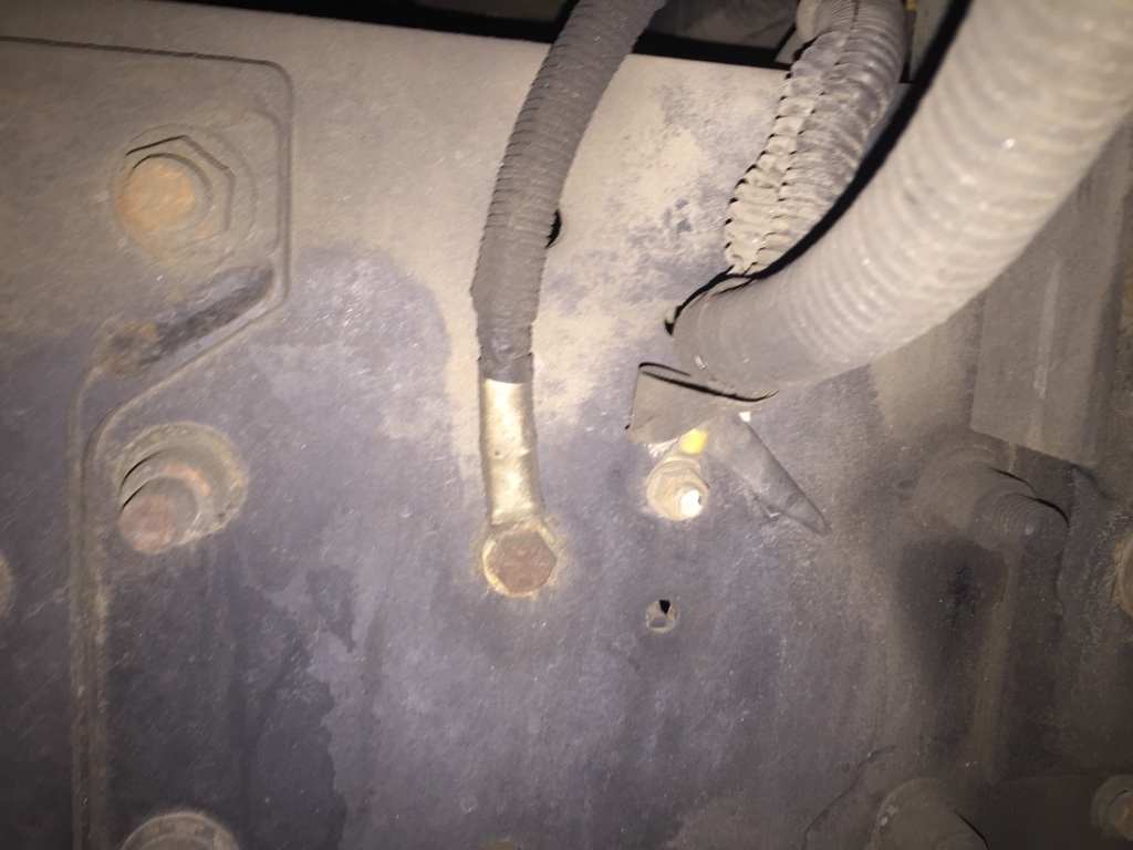

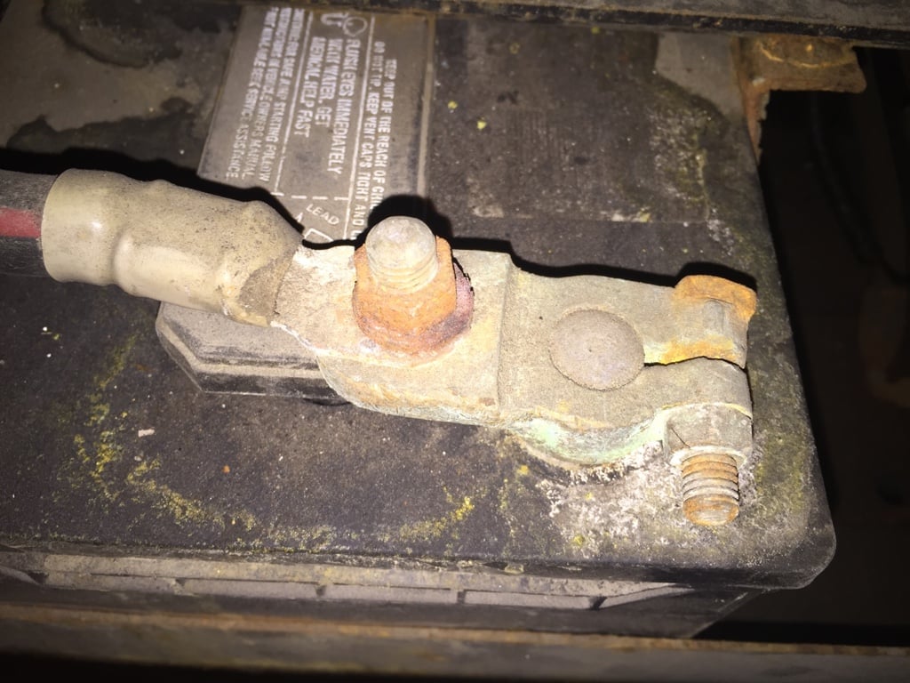

The batteries seem pretty fine to me, I haven't hooked up a tester on them yet. But without the tester no issue till after heavy rain fall
I used a actron scanner just to see why the check engine Is on, I reset it today and all that came on was the low voltage. Reset it again and voltage and the scr malfuntion.
I'd check all of your battery connections and the ground wire on the left rear of the cab to the frame. This connection has paint behind it, and all of the paint needs to be removed and the wire bolted to bare metal.

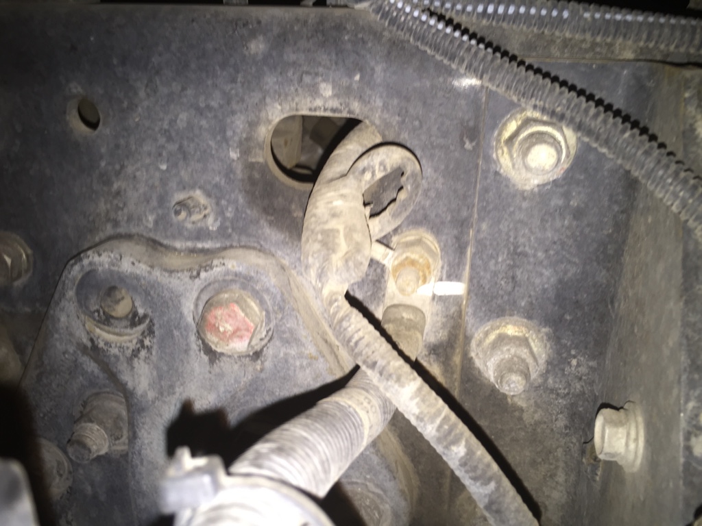

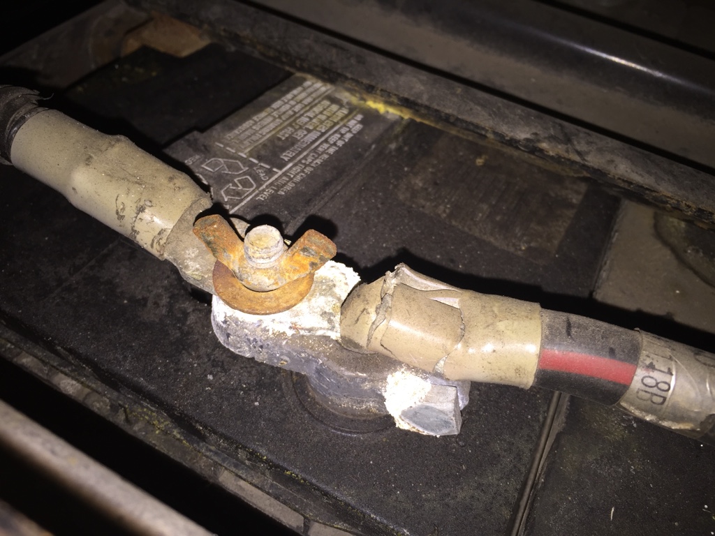

Both negative cables in the first two, and both positive in the third pic
I'm assuming these are the ground?

See how that washer turned purple? That got hot. Bad connection.
These connections look like :censoredsign:. Clean all of that up.
There's a ground wire on the left rear of the cab that goes to the frame. Sand both points until they are bare metal.
These connections look like ****. Clean all of that up.
What's the best thing to clean these connectors?
Where at behind the cab on the rear left? Is it the one in the picture? Or is it In a whole different location?

Was behaving for a day after cleaning the. Bam low voltage again and a check a/t message pulled over in a police parking lot, unhooked the batteries, got new ones and now not a single voltage problem. One of the batteries was bad, with the other one holding about 50% charge.
greasytshirt
Mechanic
That'll do it. Hinos do not like bad batteries. At all!
Now check the charging system output. Turn every electrical accessory on. It should be putting out around 13.5 volts. Check for AC voltage, it should be less than, idk, 0.2-0.3 volts or less. AC voltage messes with DC electronics and destroys batteries. If you see AC voltage, it means the diodes in the alternator are dying.
