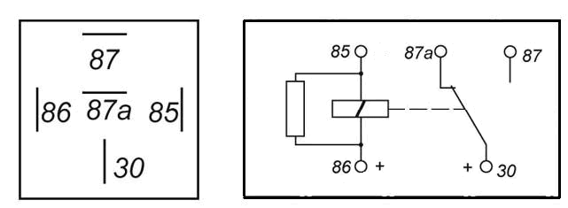

Ok, this is why the warning light is on. Check that motor and the big relay next to it for proper function.Perfect I'll grab one.

Also pulled the relay off, and I'm not getting a single reading from it I'm assuming my relay is bad
