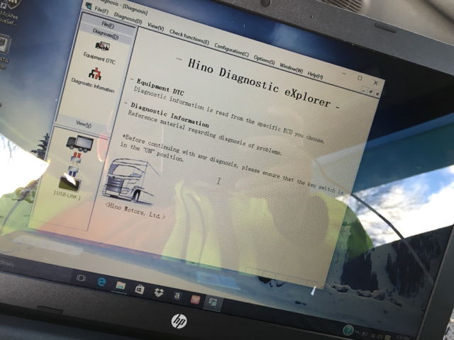

On a different note, received the diagnostic tool, set up and this is what the Hino program looks like.
Yes, that is the older Hino DX program.
