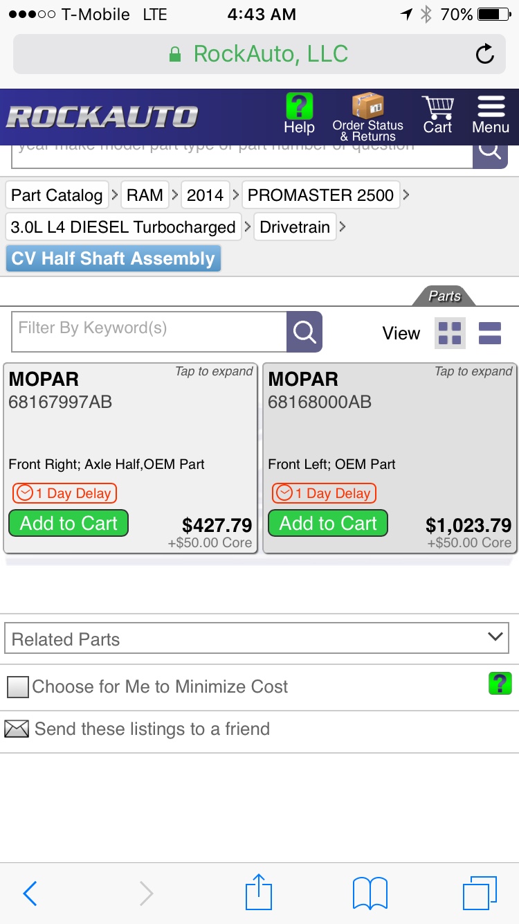

Ouch.... never seen axles that are that expensive....
Now they do have ball joints for $47....

My promaster is back in the shop. This time its ball joints and cv axle problems. Aftermarket parts wont fit, need genuine mopar. Shop ordered parts this Tuesday, special order. I asked why they cant be overnighted instead of next Wednesday. I was told it cost too much. I am paying for it, let me decide what cost too much. Not having my van all of this week and most or all of next week is saving me money how? And the repair estimate is about $3750

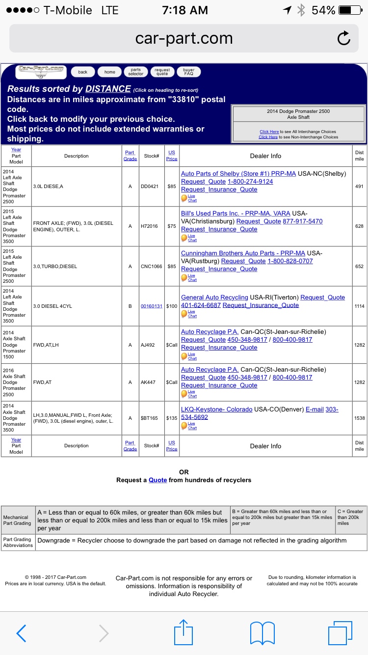

Got my van back a few days ago, the new parts helped a lot. I ordered new tires and will get them on in next few days. The shop that put in my cv axles said that the ram parts book showed same axle for gas and diesel but when the parts came they did not fit. He contacted the ram rep and from my vin number were able to acquire the correct axles. Im to go back to his shop after putting on the tires for an alignment. I will post the correct part numbers for the diesel promaster. Also he said he ordered another set to keep in stock and to let other owners know he is ready to assist with their van. The shop is called Zellners Alignment in collierville tn a suburb of memphis. Zellner Alignment and Automotive
