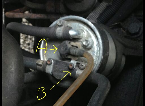

The 2nd screw (B) does not fit tight, but I don't think that's where its leaking from, although really hard to tell where its coming from.
Part (A) is in pretty rough condition and I think it needs to be replaced. I took a chunk out of the O-ring while trying to use a screw driver to help pry it loose on first attempt. Opps :oops:
I'm going to try to find a matching O-ring to replace. If that don't work, I guess I'll have to drip my way down to Wayne and let him fix my mess :rolleyes:
Since that screw doesn't tighten all the way, seems it is stripped. It will need to be replaced more than likely. If you plan to replace it, try a slightly bigger screw. That screw loose will make you to prime the filter before each start. It leaks, it's also sucking air. You could try a little masking tape on the screw and see if it will then tighten.
Reactions: RoadTime
Thanks, I'll give that a try.
I was able to confirm that it is (A) that is leaking. Sucking a lot of air, so both may be contributing.
Sorry have to ask- is the drain value closed tight?
Yeah, once I found out I needed to put the old drain valve on the new fuel filter. No wonder it would not start the first time :rolleyes:
Well with my Luck lately, this just figures...
