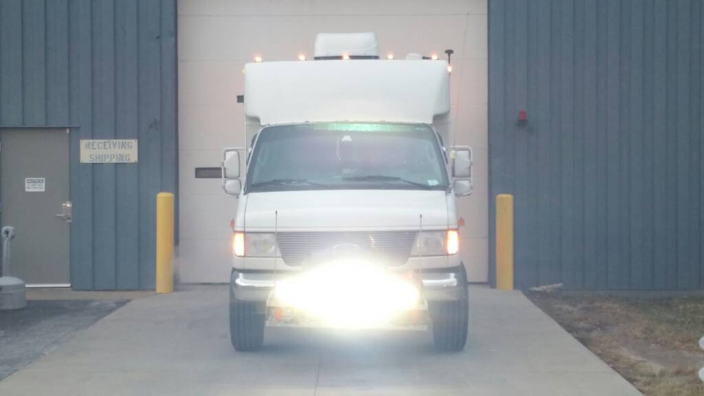

If I was going to pick one it would be the Chevy. Unless the Nissan has fog lights also. Got to have fog lights
A 750 watt lightbar works just as good..lol..
