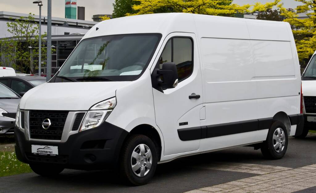

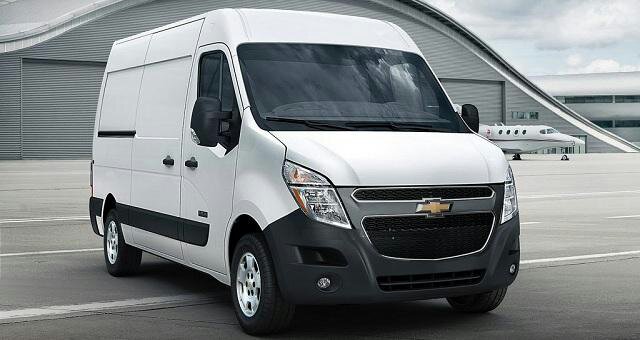

If Nissan made a 12 ft or longer vehicle I'd seriously consider one of those. Hardly hear of those owners having problems.
Nissan and GM are making 1 together ... pick the badge you want it to wear ...
Reactions: DollarSign
They also build the same mini van which is even more ugly!
Lost in Space.
The new models remind me of the old Chevy Astro vans ... in which i had a 95 cargo van ... V-6 gave great MPG and good HP ... the 3000 lb.payload is what i will ? when they finally become available ...
