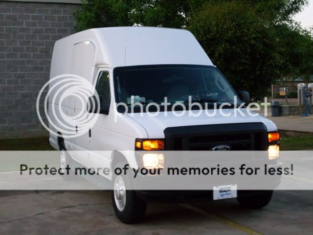

you can get an hcv from vision mfg at watson quality ford of jackson ms for the price of a ford cargo van. that is about 12k off the conversion price. call bill molitor at 601-956-7000. tell'em i sent ya!
they ordered 450 in 2008. they have 32.....31 left. 5.4, 4.6 and 6.8 gas engines and the 6.0 psd. no cruise but i was told the wiring is there and all you need to do is buy a cruise ctl steering wheel and buy the buttons.

i was told ford runs in the engines for 3 hrs at the plant then drains the oil getting out all those pesky metal shaving. no break in just go.
we had 4 tanks of fuel. jackson to memphis was 14. sumpin. memphis to matthews mo was 15. don't remember the matthews to eff'ham but the final to home was 16.7 all about half tanks 200 miles or there about except the last one over 300. tank size is 35 gal.

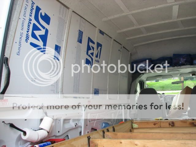

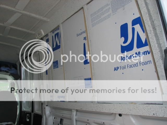

started the insulating project today. bought johns manville 3 sheets 1" poly board one side foil, 2 tubes of power grab by loctite in the aerosol can and some foil faced styrofoam 1/4" to use as, well shim is not the right word. maybe i can think of it later.
here is the wall and ceiling view.
here is the driver side with the poly sty installed.
when the ceiling is done the reflectix gets put in. like to do it from the center to the sides. maybe take 2 rolls 48" x 25'. use the extra for the doors.

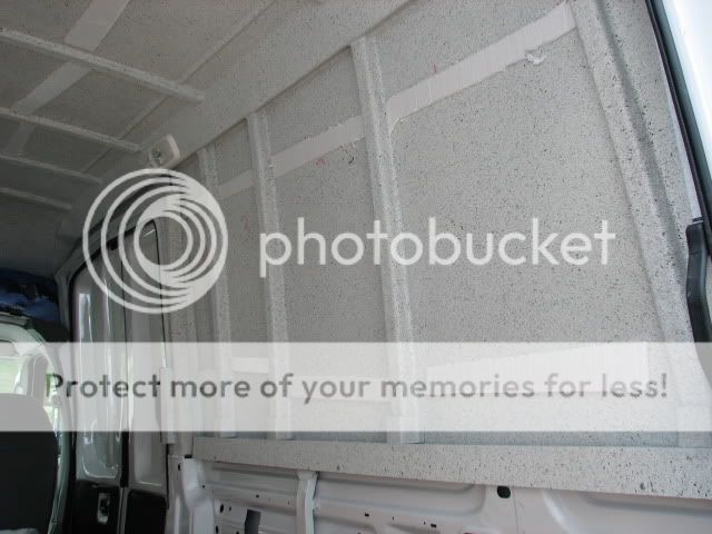

passenger side done

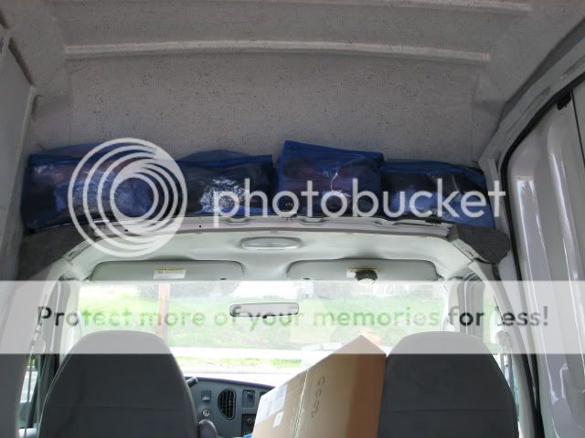

storage over the cab for 2 x clothes, 1 extra clothes and 1 x knitting projects. the qc will hopefully be installed here somewhere.

Now are you going to use rolls of bubble foil to cover the whole thing...I see the ribs are still exposed..
I also see you have your TP hanger installed already...*L*
