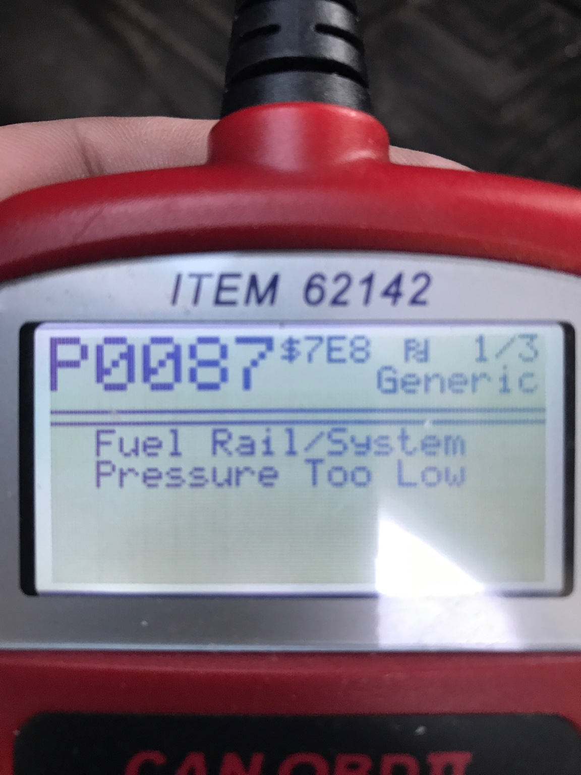

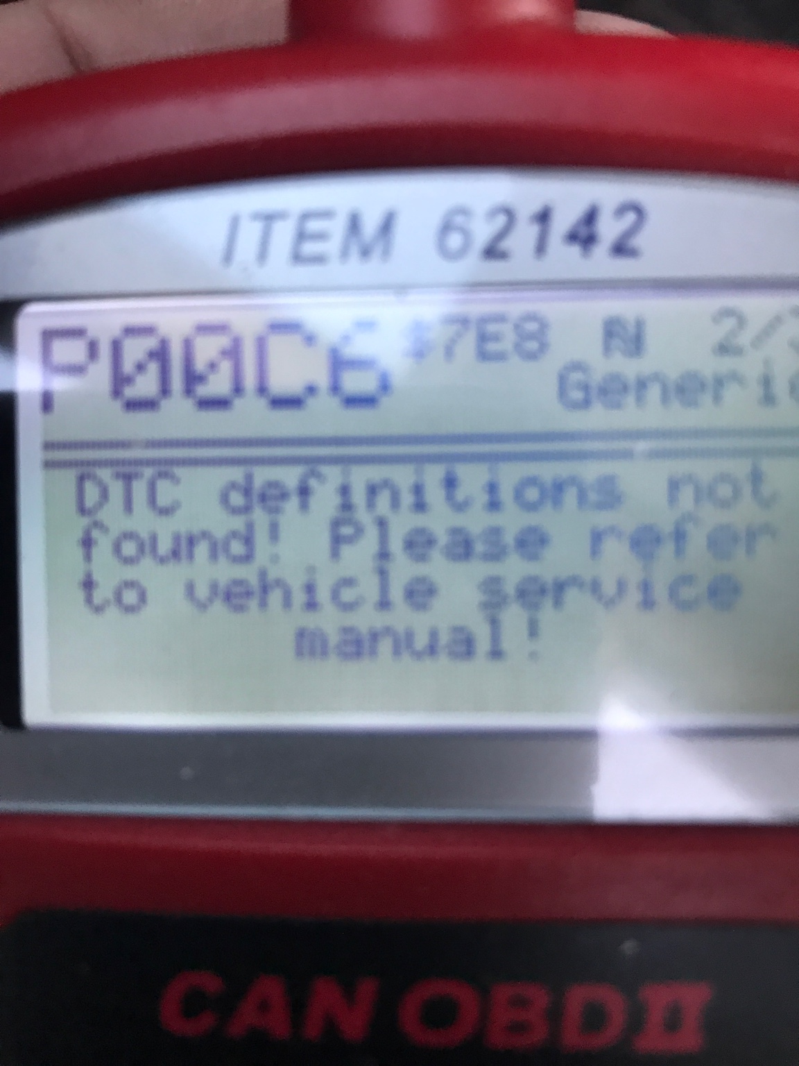

And more Transit woes! Went to start my van Monday evening. Barely started and then chugged and died. Cranked but wouldn't start again. So I disconnected the battery to give the system a reboot. Went in and had dinner, reinstalled the battery cable and it started. Called my Ford tech friend where I purchased my Transit. Told him exactly what problems I was having. We talked about 20 minutes and he gives me his diagnosis. He said that the "fuel pump control/driver module" sounded like the issue. He even gave me the part number! So I drove over to the local Ford dealer here in Barstow, CA. They had it in stock and a tech heard me describing the issue and offered to change it right there in the street for $30 cash. The part was $66 including the taxes. So far it's been starting great every time since.
That sounds exactly like what happens when the bcm does not detect the transponder key, I wouldn't change anything yet, since you unhooked the battery it erased the code but I bet if you would have checked there would have been a code set for it.
billg27
These were the codes.
