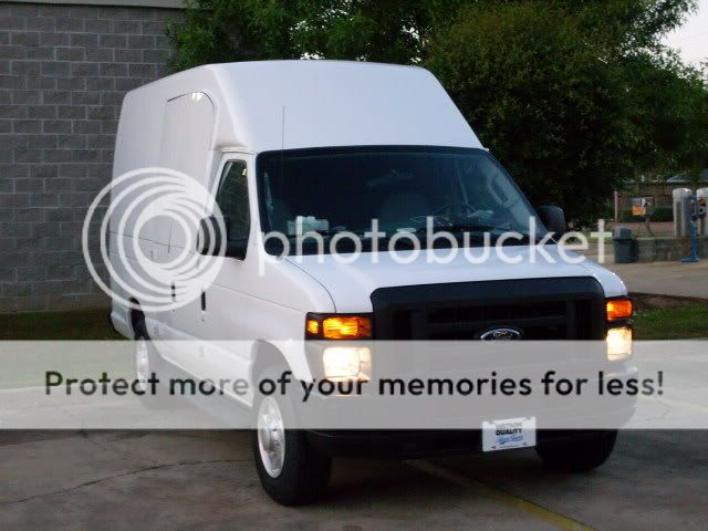

Would love to add cruise to my 2003 Ford E350 w/7.3 diesel but have not found anyone or any site that offers it. Any suggestions?

think i am getting set up in my own thread.greg it is not the std cargo van. its not a sprinter. like i said its one of 2 in our fleet and now one with the cats.
