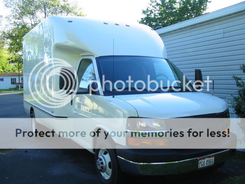

CB ANTENNA MOUNT --- SWR CAME OUT AT 1:1
FIA SNAP ON BUG SCREEN --- WHEN IT GETS COLD A WINTER FRONT SNAPS ON IN PLACE OF THE BUG SCREEN

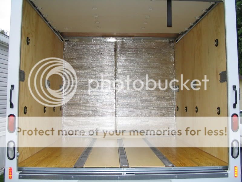

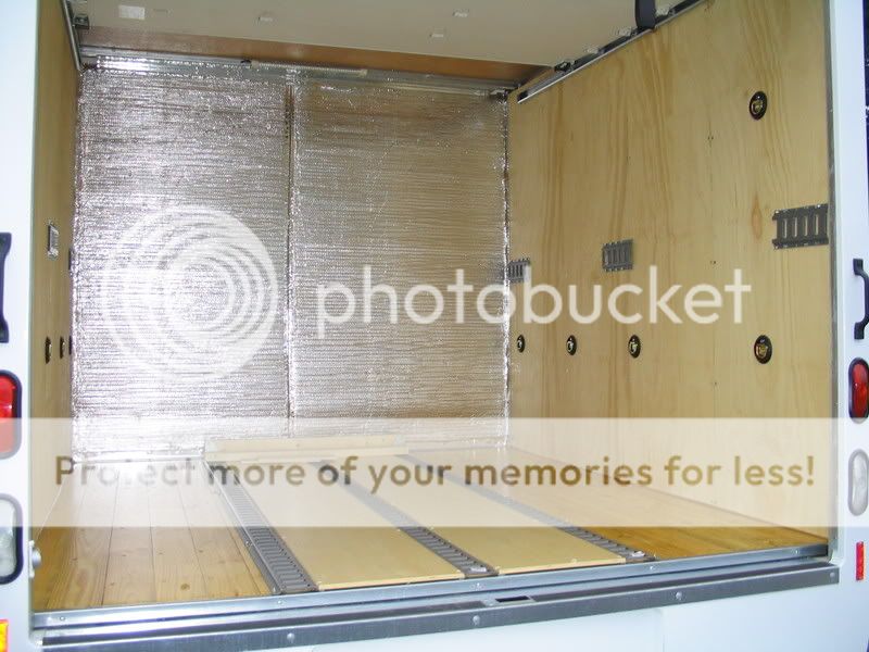

INSTALLED E-TRACK AND D-RINGS --- USED CUT OFF E-TRACK PIECES ON SIDEWALLS --- REFLECTIX INSULATION ON BUNK WALL

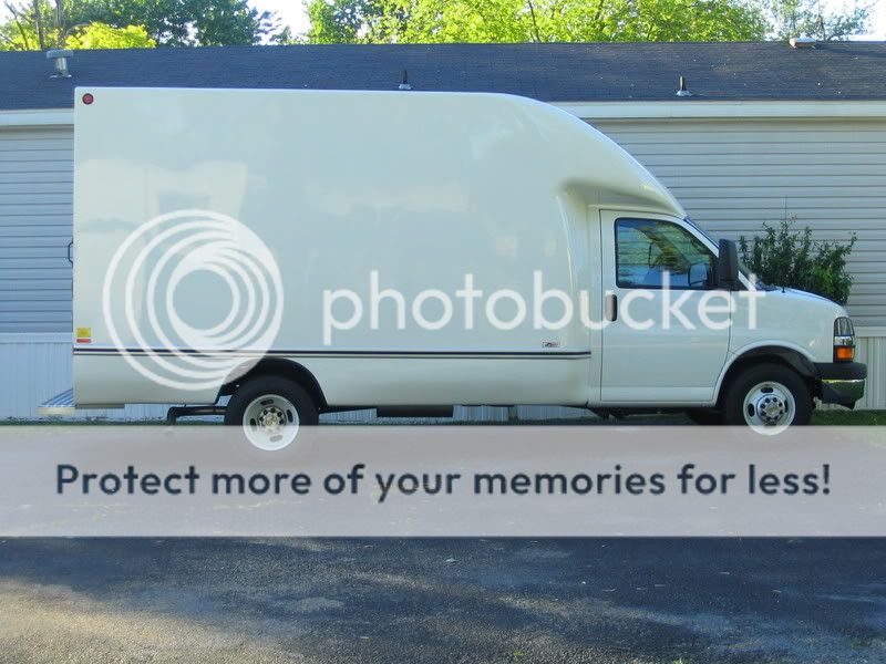

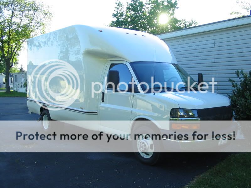

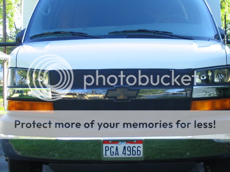

NEW BUMPER TO BANG. OUCH!!!

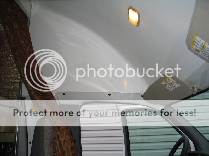

60 LED TUBE LIGHT --- ANOTHER ONE IN BUNK AREA TOO --- IF I TURN THE ON/OFF SWITCH FAST ENOUGH THE REFLECTION BOUNCING OFF THE FOIL INSULATION REMINDS ME OF A DISCO.
WOW! I CAN ACTUALLY STAND UP AND GET DRESSED WITHOUT BUMPING MY HEAD OR FALLING DOWN.

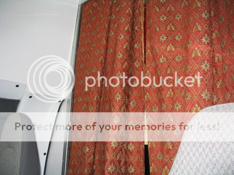

DRAPES FROM LOWE'S. REGULAR $29.99 EACH. ON SALE AT $5.62. wHAT A DEAL. USED 5 FOOT PIECE OF PVC PIPE AND THREE PLASTIC PIPE CLAMPS FOR MY ROD. A REGULAR ROD WAS $24.95. THE PVC PIPE AND CLAMPS WAS $4.67.

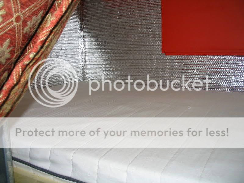

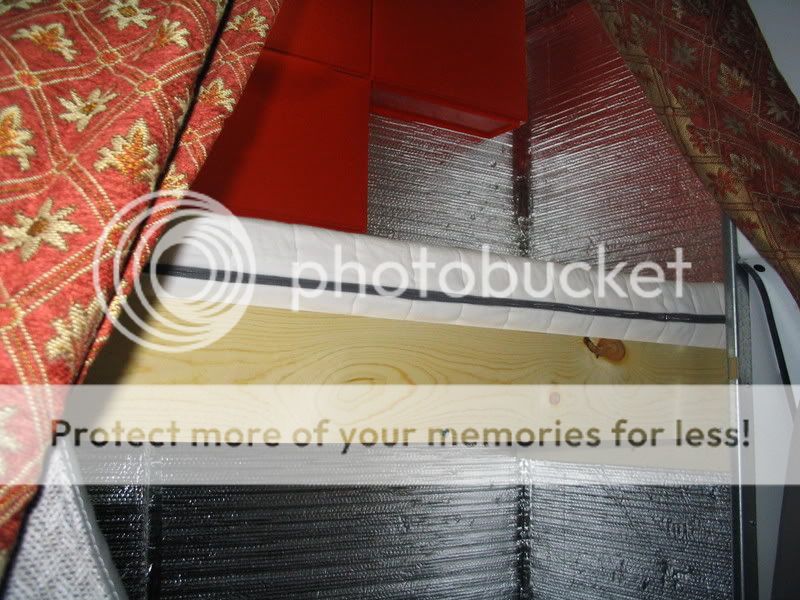

A REAL BUNK!!! A REAL BED!!! LOTS OF ROOM!!! I ACTUALLY BUILT SOMETHING.

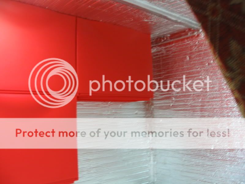

MATTRESS AND RED CABINETS (NEEDED A LITTLE COLOR IN MY LIFE) CAME FROM IKEA.
BED --- 2X4 ON WALL AT EACH END --- 2X4 WITH A 1X6 ATTACHED TO THE SIDE OF THE 2X4 FOR EACH BED RAIL
BED SLAT SYSTEM FROM IKEA (NO BOX SPRING NEEDED). THE SLATS ARE CURVED BIRCH AND THAT MAKES THEM SPRINGY. THE SLATS UNDER YOUR HIP AREA ARE DOUBLED FOR EXTRA SUPPORT. THERE ARE RUBBER CUSHIONS AT THE END OF EACH SLAT. THE HEAD AREA HAS A RATCHET SYSTEM THAT ALLOWS ME TO ELEVATE MY HEAD FOR READING OR SLEEPING COMFORT. IT RESTS ON TOP ON THE 2X4 BED RAILS. REALLY COOL.

Great pictures! Now being the picky one that I am :p What kind of storage will you have for personal stuff? Can we see pictures of that?

NOTE THE RUBBER CUSHIONS AT THE ENDS OF THE SLATS
INSTALLED INDOOR/OUTDOOR CARPET THAT HAS A RUBBER BACKING UNDER BUNK AREA AND SEALED WITH SILICONE. REASON? THE CARPET COVERS THE CARGO TYPE FLOORING AND IT TENDS TO EXPAND AND CONTRACT WITH THE WEATHER; THEREFORE, IT ALLOWS DUST TO WORK THROUGH THE SMALL GAPS. THANKS TO DRAGONRIDER FOR THAT HINT.
ANOTHER IKEA PRODUCT. THESE ARE SHOE CABINETS. THEY COME IN PACKAGES OF THREE. I HAVE 4 ACROSS THE TOP AND TWO UNDER THAT ROW. THEY ARE DESIGNED TO INTERLOCK BOTH SIDE-TO-SIDE AND TOP-TO-BOTTOM. I ROLL UP MY CLOTHES, TOWEL, JACKET, ETC. AND USE THEM AS CLOTHING CABINETS. THEY PULL OPEN FROM THE TOP AND RST AT AN ANGLE WHEN OPEN.
