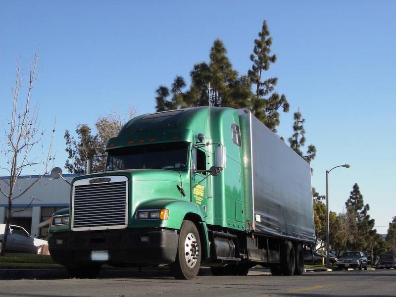

Case in point: I modified this FL120 tractor into a straight truck by extending the frame and adding the 22' flatbed with a Maxon tuckaway liftgate from my old Hino. Then i added the Cramaro convertible top. No manufacturer involved, just me, my two buddies, a plasma cutter and arc welders.
The DMV assigned a GVWR of 44,000# to this truck, giving it a 22,550# payload capability. No new placard was issued, and this truck still passes every BIT inspection.

that truck should have a GVW of 46000# 34000 rears 12000 front,maybe in CA if that is a lift axle on the rear,then maybe 32000 on the rear,or does it just have 8 tires?
zero3nine
Its a ten wheeler. By keeping it under 45000 we save a substantial amount on the registration fees. Our goal was. 20k payload since this truck is tailored to the needs of a specific customer. It runs from Irvine CA to Hurricane UT on a regular basis with two giant tooling dies weighing just a shade under 20k pounds.
