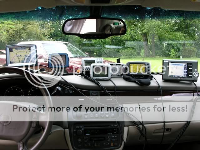

As silly as it sounds, the best option may very well be a Garmin and a 430 sitting right there on the dash next to each other, using the Garmin for more accurate routing, and the 430 to be aware of truck and restricted routes.
Funny, Turtle. I had the exact same thought a mere second before reading this paragraph. It seems that ppl use gps AND a computer program, this would only be logical to do... two gps units next to each other. Of course turning the precise one off until close would probably be a good idea. Or at least the voice. One thing I couldn't stand would be two women trying to talk over each other. I get that enough of that at home. LOL
Until they come out with the Skoti Transporter 3000, this may be the way I'm going.
Scott101
Shucks. I hate to think people would limit themselves to 2 units. :D
I kind of like the idea of 6 gps units and a compass built into the mirror for good measure
