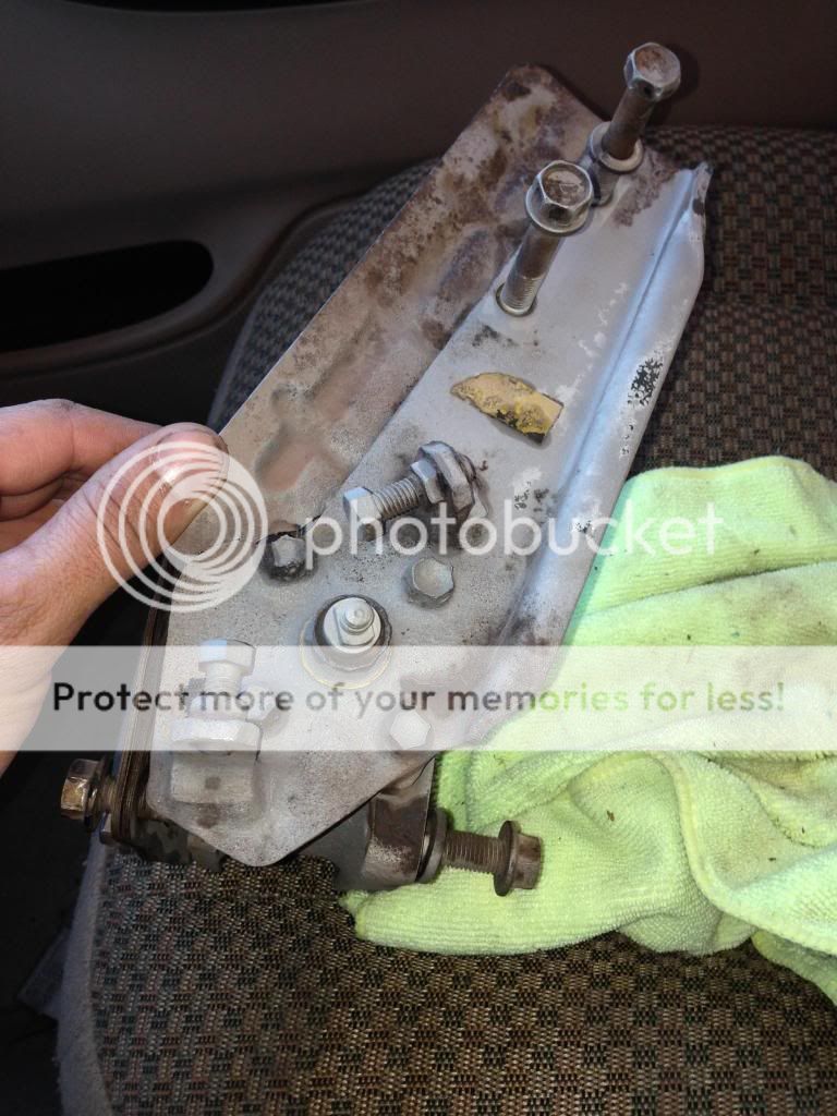

Well I took off the exhaust brake and it's seized in the open position. The bolts are also seized and I managed to strip them all of them. So I'm gonna price this out now.
Last time I checked, an exhaust brake was like $600 or more. Hopefully you can get the stripped bolts out.
Hino3325
The local hino dealer says its $728 and there's no replacement parts for it.
I'm soaking it in some lemon juice and baking soda mix and hopefully it frees up, if not I'm gonna have to put the machinist hat on!

Hino likes using stainless steel hardware on pretty much every single thing on the exhaust. This is generally a good idea, except for one thing: When a stainless bolt and a stainless nut are used together with nothing between them, they will gall. Galling is almost like when the threads weld together, and when it's twisted, the metal (hopelessly stuck together) smears together instead of breaking free. When this truck was initially put together, many of the bolts and studs were copper plated. This is the 'thing' between the threads I mentioned. It works fairly well, but years later the copper has reacted with road salt and moisture and whatever else, and basically disappears. Stainless steel can also bond itself to cast iron very tightly, which is probably what you're experiencing. If the stainless hardware doesn't immediately break free when you put loosening torque to it, it's time to either heat it up (red hot), impact it a few times then soak with good penetrating oil, or (if possible, or applicable) split or cut the nuts off (ouch!).
Drilling out broken stainless bolts and studs on a Hino is usually very difficult. You're gonna need very sharp drill bits, and turn them very slowly. It takes forever.
If you know a MAC tool guy, MAC is one of the few that will actually warranty a broken or dull drill bit. Snap-On does not.
One drill bit that's particularly good is made by Viking. I forget what name they gave the bits, but they're a high-molybdenum bit, 118 degree, with a split point. The shaft has three reliefs milled in so that they won't slip in a chuck (a feature worth it's weight in gold). Turning these very slowly, using no lubricant, and allowing them to cool frequently has produced the best results I've seen.

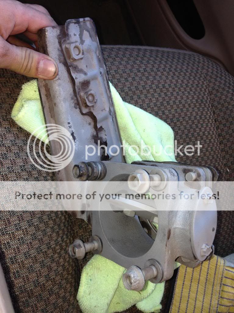

I had soaked it in the lemon juice baking soda mixture it didn't do much so I sandblasted it, it was caked with rust n got nice and clean. After that went to buddy's place and he has a lot of machining tools and I ended up heating it up, worrying if there's any rubber seals that will melt but ended up removing the 2 bolts on the top part with heat and vice grips and then 4 at the bottom got 3 out but the forth had to drill thru it, but it's all taken apart and no rubber seals.
Gts your rite about stainless bolts and cast it literally welds itself together, that's what I was thinking y would they weld these bolt on until heating it up and it cracked open. Anyways I sandblasted the rest of the parts and painted it and put some graphite at all the moving parts and put it back together so tomorrow I'm gonna reinstall it and hopefully it functions.

Put antiseize on the threads before you reassemble it.
While I prefer the nickel antiseize, copper works pretty well too. Even regular antiseize (which I don't think works all that well in high heat applications) is better than putting that back together with dry threads.
But that looks pretty good, and I'm sure it'll work fine at this point. Occasionally I'd spray that nickel antiseize on the moving parts so you don't have to fuss with it any more.

I put antisieze on the new bolts and all moving parts and installed it, it's working like its suppose
to :) I definitely saved myself some $$$ by taking it apart myself.
