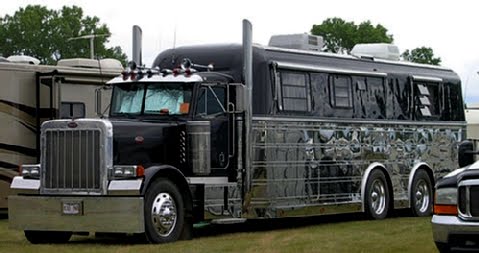

The thing is, the poster is not contracted to anyone...there is no company name yet so there is NO US DOT # to display....just a big RV till they get to orientation
