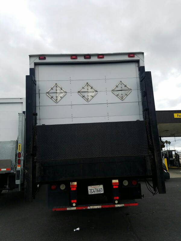

Is Penske selling this truck direct or a third party? I wouldn't think Penske would put a truck up for sale that wasn't road ready and legal.
It may very well be road ready and legal within the state of California, but not for interstate commerce. One would think that things like external truck lighting regulations would be more or less uniform across all states, following DOT regulations, but this is California we're talking about, so I dunno.

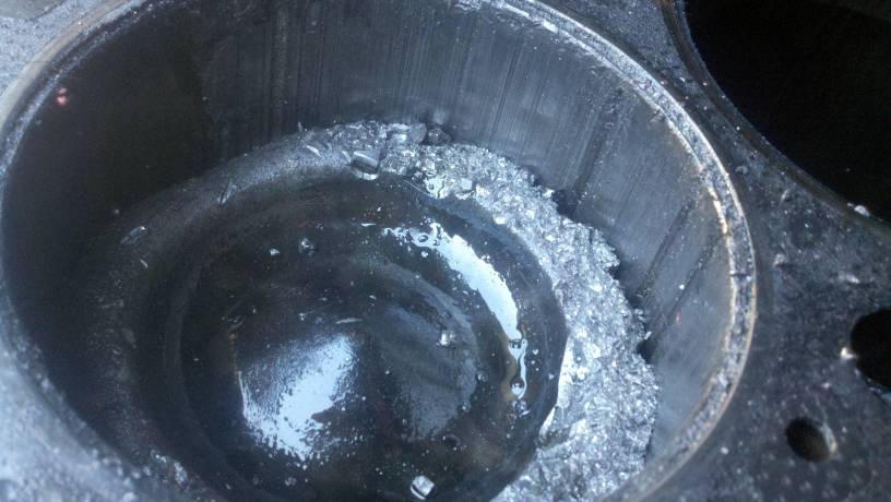

I'm not impressed with these engines at all. In fact, there's one dead in my yard, exactly like yours, but with 100k fewer miles. It just randomly blew up one day. Shredded cylinder wall. Parent bore block, no removable liners, needs to be removed from the chassis and sent to a machine shop to be fixed properly.
Start stuffing your mattress. Prepare for the worst and hope for the best.
Sorry for raining on your parade.
Here's a pic from a different C7 that failed even worse.
