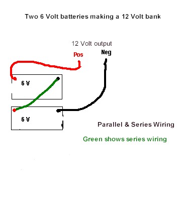

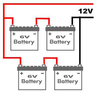

Where's the diagram showing 4 6v batteries with all the wiring?

I don't think you do understand. Look at the graphic again. The two unattached wires are the positive and negative leads of the 12-volt output of what is NOW a SINGLE 12-volt battery. The two 6-volt batteries no longer exist insofar as charging and discharging is concerned. Once that "green" wire is connected, as if by magic, the 6-volt battery disappeared and in it's place is a 12-volt battery. 12-volt batteries are comprised of six cells of 2-volt each, and that's exactly what you have when you connect two 6-volt batteries with three cells each together. Once you connect them, they are no longer independent. They are merely six cells all strung together to create a 12-volt battery, and should be treated as such.

Take a close look at the above. Each of those pairs (left-right) of 6-volt batteries are connected in series to each other positive to negative, making each pair a single 12-volt battery.
Then, all of the positives from each pair are connected in parallel, as are all of the negatives of each pair. The result is the positive and negative terminals at the far left and far right where all the connections go to, end create one really large 12-volt battery, and none of those 6-volt or 12-volt pairs even exist anymore. It's ONE battery, 12-volts. Period.
Whether you have a one bank, two bank, or whatever bank charger, you only have one battery there, with one positive and one negative terminal, so all of the leads go to the same positive terminal on the far right. All the negative leads go to ground, and you would, of course, ground the (now really big, single) 12-volt negative terminal.
