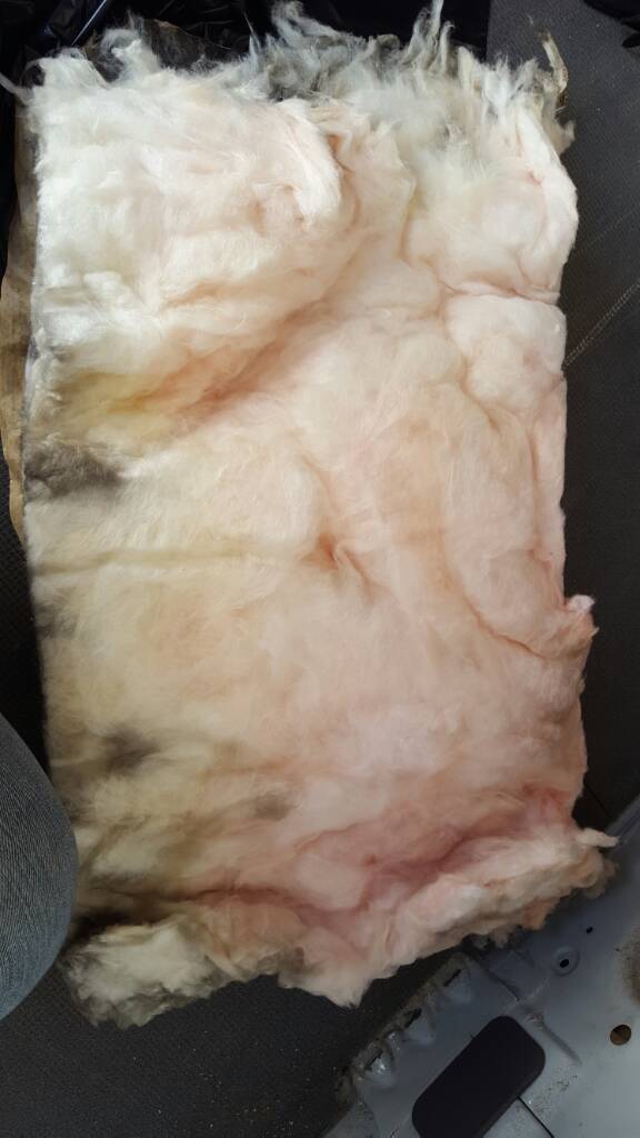

As you can see below dirt, moisture and dust was not a major issue after 4 1/2 years I do have an espar that dries the air a bit and my ceiling fan is always set on exhaust which may help with moisture.

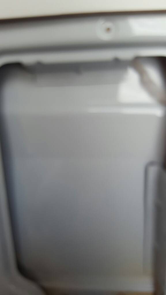

Where the damage was and the body was pushed away from the black plastic panel water intrusion became an issue fast. Below is where the snaps on the plastic protrude the body also in that area the insulation was soggy at the bottom.
Where there is not damage the area around the plastic pins is fine. The light and dark areas are just spray glue and dirt if you look closely around the pin there is no rust.
I guess I have two points. To me using fiberglass insulation is fine without fearing dust and moisture. If your a buddy heater person that could be different.
