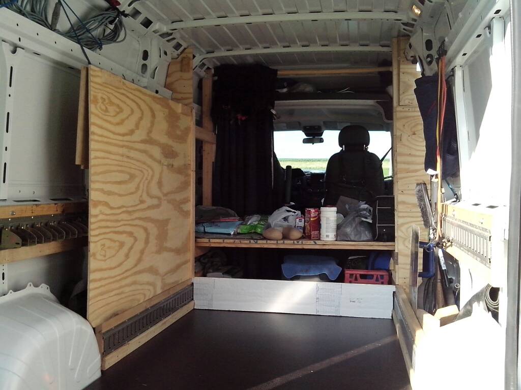

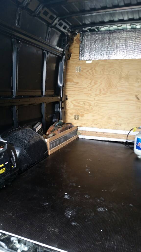

My promasters have came with the Black floor installed in at factory ... no need for extra plywood needed ...carry a cheap broom and very easy to keep clean ...IMO
My E-trac are fastened to 2 x 10 's that are fastened to 2 x 6 that are anchored to D-rings in floor ...

well from all the vans ive looked at they didn't have that floor its just the standard white sheet metal. But I am interested in how you mounted that partition? really the major confusion I am having is how to properly mount everything, other than that I have a few blueprints of how I wanna set it up in my head. Very nice vans btw I like the set up

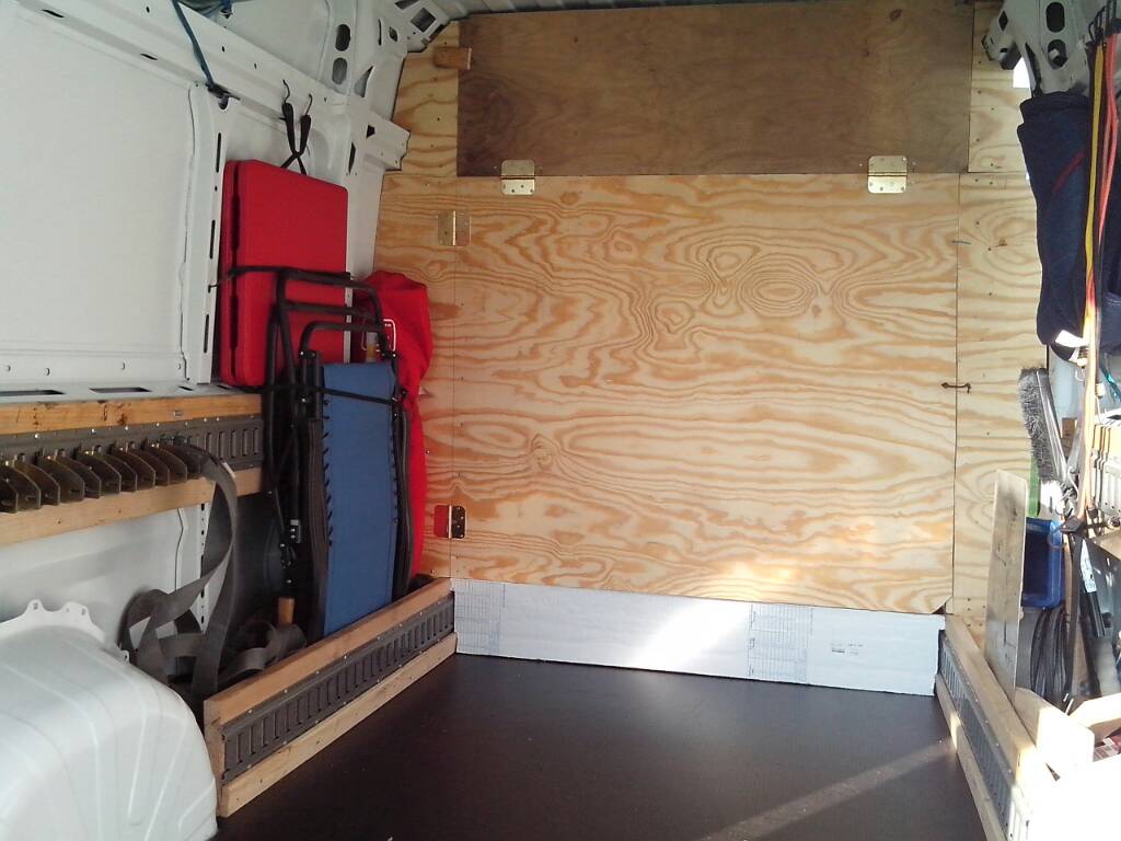

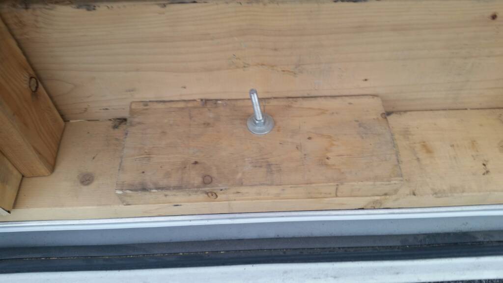

The 2 x 6 to floor i use door knob cut out tool to position board over D-ring .. then put short 2x6 on top and drill small hole to fasten J-hook to tighten up ...
For partition .. 2x2 mounted inside of bottom Etrac support board and L shape corner bracket at top sheet metal screwed in ..doesn't effect the 55 " inbetween wheel well for freight ... on the 159" inside length ..i put partition at around 102" mark from back doors ... normally i haul 2 skids or less so door is closed in bed area ..if need 3 skid room ..open up door and adjust bed as needed ..my bed goes crossways and will fold up behind seat as i only give 148" for freight
