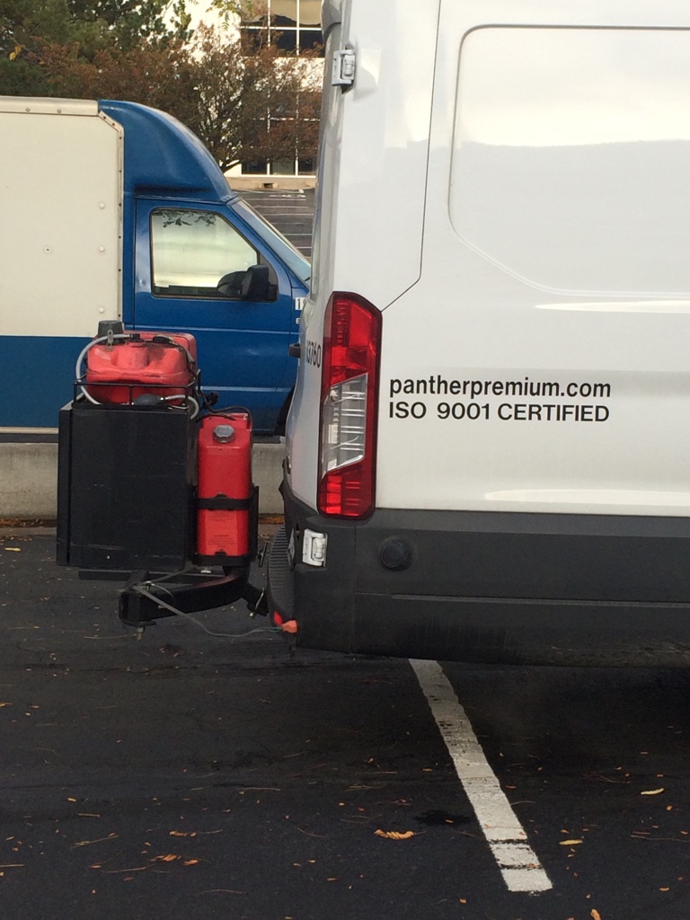

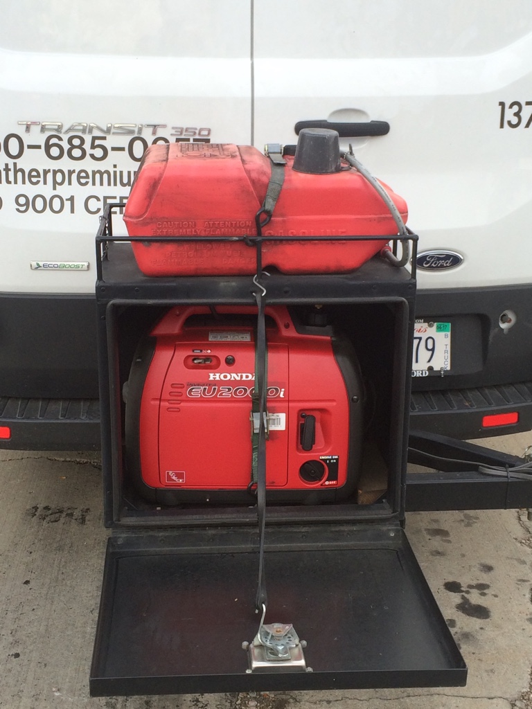

How about posting a few pictures showing it both open and closed.
Mine is stout and you could stand on the end of the thing. It wasn't cheap to have built but they have been doing them for years and constantly improving them. They custom build it to your van and the footprint of your generator and aux tank. Anyone want the info pm me and I'll be glad to pass it on.
I do wish mine was anodized plan to have it done at some point.
I should add a single receiver will spell sag in a few months always look for a setup with a second receiver on it.

I got the one billing27 is showing (stowaway2). On the ford transit you have to remove the quick release, otherwise your back door hits it. I also had to drill another hole for the hitch pin. Where they have it set it sticks out to far. Otherwise it works great even had enough room to mount a Jerry can on there too.

I'll try to remember to take a couple tomorrow. It is just to add support and stability, it attaches to the main bar like the other receiver and adds a lot of strength. You can stand on the end of that bar with no flex or twist. When the swing arm is swung wide it keeps it from doing the same. I would recommend anyone add a second to any pre-built unit.
