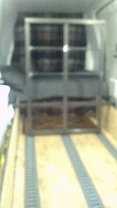

When placing e track on the floor of a cargo van...what is the best position (measurment between tracks, how close to wheel wells etc...)?
I'd go about 91 centimeters, but more importantly mount it so the screws and bolts hit the raised floor ribs.
Here is a pic of mine. I just measured and the two outside rows are 38" center to center. Seems to work out about right. The center row is very handy.
Rocketman
Where's the French Door lead to, the patio? :rolleyes:
barely anywhere. This setup almost eliminates access..lol. It is still usable...and handy... but definitely restricted. I really like the current setup though.
Now...if your talking about that metal structure on the side.. that is a bulkhead.

My E-track is about 34" center to center or roughly 86mm.
