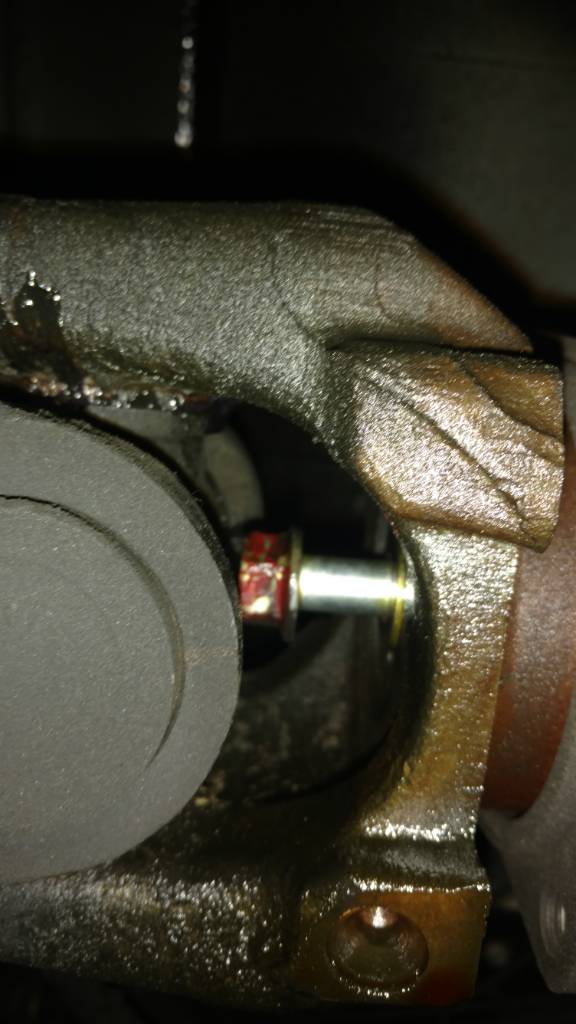

Driveshaft phasing: no one knows what it is.
greasytshirt
Mechanic
Including the people tasked to reinstall them.
The two pieces of yellow tape are on the u-joints, and are supposed to line up. They're almost 90 degrees off, so the piece of tape on the right of the pic is nearly impossible to see.
So, what's the big deal? U-joints let things run at angles, right? Yes, but they create forces that have to be cancelled out. With a phasing issue like this, multiple things will go wrong. In this case, the bolt holding the transmission yoke vibrated loose and it trashed the seal.
Some of you are suffering from this right now and are unaware of it. Check your shaft!

Exactly. That's the same thing that happened on this truck. It was towed and when the shaft went back in, it went in at random.
The ones with the master spline have the one spline filled with plastic, and if you try really hard you can force them together. Getting them back apart requires dirty language.
