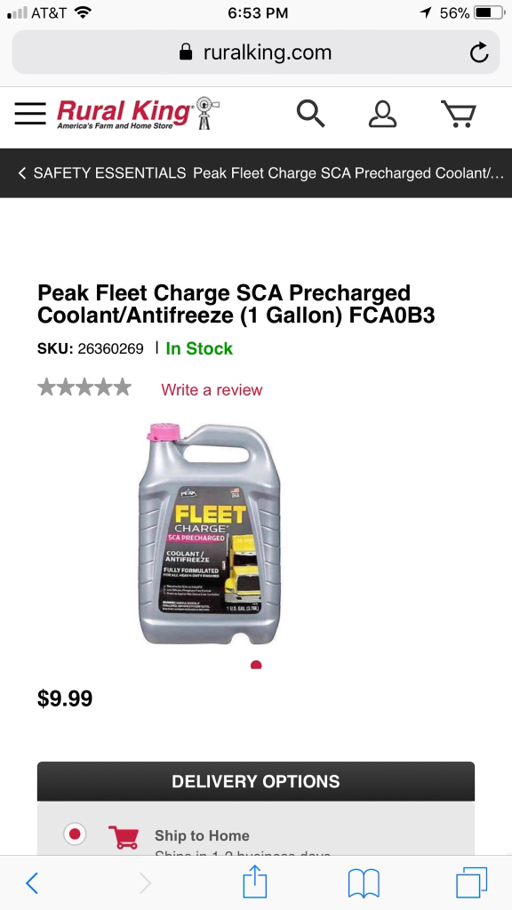

Is it the orange color? Just want to make sure it's the same as what I have in the truck currently, don't want to mess the engine up. Thanks
ajakapari
It’s pink . It’s the same as the orange one it’s heavy duty coolant for trucks..
I topped off my m2”s with this coolant many times u won’t have trouble .
Thank you so much! Will pick up couple bottle tomorrow.

I would send greasytshirt or hino123 a pm and ask them since they are our resident truck mechanics before adding any other color fluid. JMHO.

Mixing coolant colors........bad....unless you are 100% sure of the compatibility.
ajakapari
It is compatible .
That one is not pre -mixed when u mixed it with water it turns orange ... I’ve used it many times. With no problems over the years it’s for heavy duty trucks....

I would not mix an SCA-precharged coolant with an extended life coolant. Your truck probably came with an extended life coolant, and the one in the pic is an SCA-precharged coolant.
I don't know what you have in there. The color means nothing.
piper1
You're right....coolant color doesn't matter....if you know what you are doing. If you don't....it's an indicator that you may need to ask somone who does.
